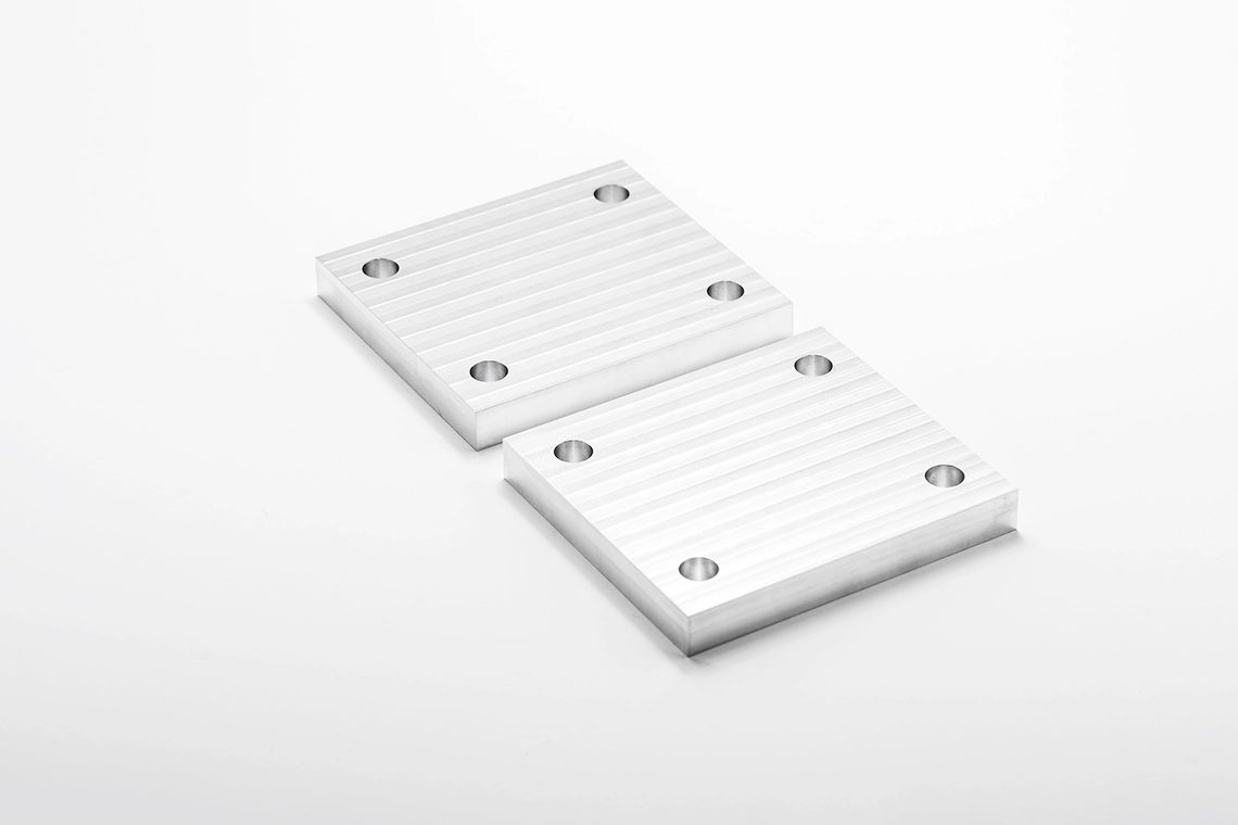

What is aluminum? The robust, economical alloy
cnc-materials-Aluminum-1
A component made of Aluminum 6061
Aluminum alloys have an excellent strength-to-weight ratio, high thermal and electrical conductivity and natural protection against corrosion. They are easy to machine and cost-efficient in bulk, often making them the most economical option for producing prototypes and other types of parts.
While aluminum alloys typically have lower strength and hardness than steels, but they can be anodized, creating a hard, protective layer on their surface.
Let’s break down the different types of aluminum alloys.
  • Aluminum 6061 is the most common, general-use aluminum alloy, with a good strength-to-weight ratio and excellent machinability.
  • Aluminum 6082 has a similar composition and material properties to 6061. It’s more commonly used in Europe (as it complies with British Standards).
  • Aluminum 5083 has higher strength than most other aluminum alloys and exceptional resistance to seawater. This makes it optimal for construction and marine applications. It’s also an excellent choice for welding.
Material characteristics:
  • Typical density of aluminum alloys: 2.65-2.80 g/cm3
  • Non-magnetic

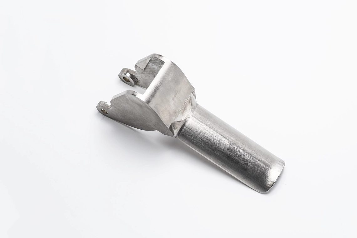

What is stainless steel? The strong, durable alloy
cnc-materials-Stainless steel-4
A part made from Stainless Steel 304
Stainless steel alloys have high strength, high ductility, excellent wear and corrosion resistance and can be easily welded, machined and polished. Depending on their composition, they can be either (essentially) non-magnetic or magnetic.
Let’s break down the types of stainless steel we offer on the platform.
  • Stainless steel 304 is the most common stainless steel alloy. It has excellent mechanical properties and good machinability. It’s resistant to most environmental conditions and corrosive media.
  • Stainless steel 316 is another common stainless steel alloy with similar mechanical properties to 304. It has a higher corrosion and chemical resistance though, especially to saline solutions (for example seawater), so it’s often better for dealing with harsher environments.
  • Stainless steel 2205 Duplex has the highest strength (twice that of common stainless steel alloys) and excellent resistance to corrosion. It’s used in extreme environments, with many applications in Oil & Gas.
  • Stainless steel 303 has excellent toughness, but lower corrosion resistance compared to 304. Due to its excellent machinability, it’s often used in high-volume applications, such as producing nuts and bolts for aerospace.
  • Typical density: 7.7-8.0 g/cm3
  • Non-magnetic stainless steel alloys: 304, 316, 303
  • Magnetic stainless steel alloys: 2205 Duplex, 17-4

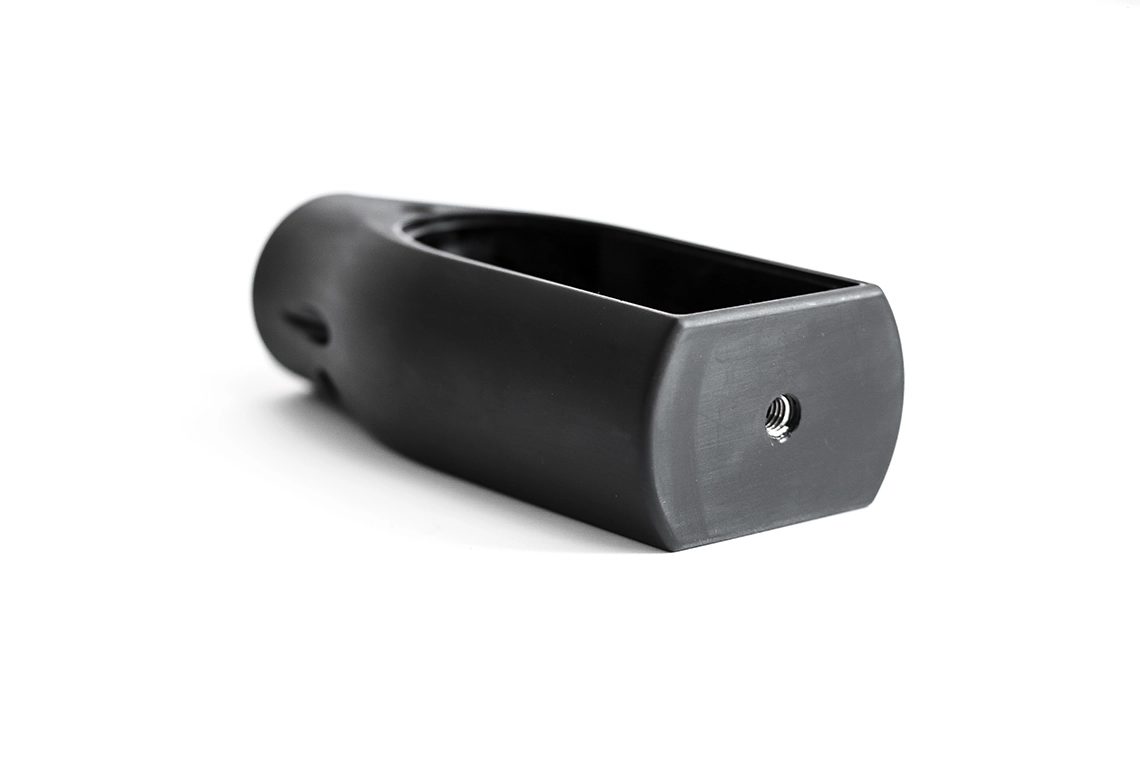

What is ABS? The prototyping thermoplastic
cnc-materials-ABS-1
A part made from ABS
ABS is one of the most common thermoplastic materials offering good mechanical properties, excellent impact strength, high heat resistance and good machinability.
ABS has low density, making it ideal for lightweight applications. CNC machined ABS parts are often used as prototypes prior to mass-production with injection molding.
  • Typical density: 1.00-1.05 g/cm3

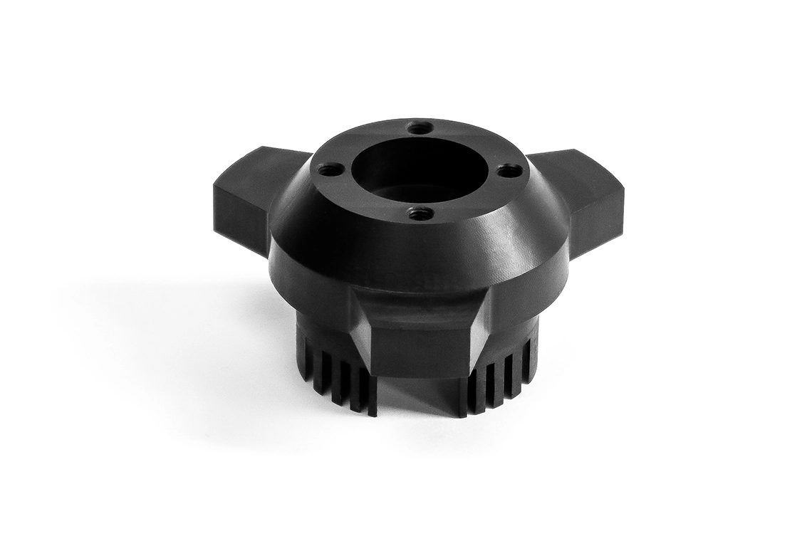

What is nylon? The engineering thermoplastic
CNC'd nylon 6 part
A part made from nylon
Nylon (aka polyamide (PA)) is a thermoplastic that is often used for engineering applications, due to its excellent mechanical properties, good impact strength and high chemical and abrasion resistance. It’s susceptible to water and moisture absorption.
Nylon 6 and nylon 66 are the grades that are most commonly used in CNC machining.
  • Typical density: 1.14 g/cm3

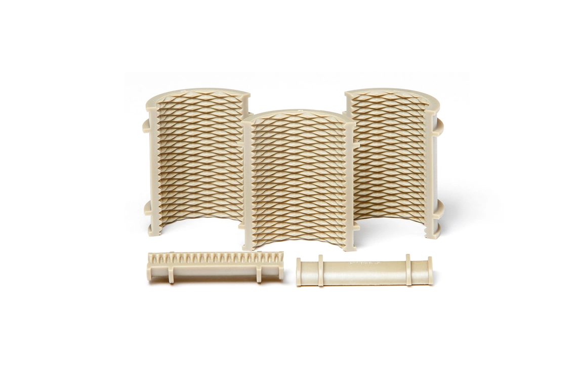

What is PEEK? The plastic to replace metal
cnc-materials-PEEK-2
A part manufactured from PEEK
PEEK is a high-performance engineering thermoplastic with excellent mechanical properties, thermal stability over a very wide range of temperatures and excellent resistance to most chemicals.
PEEK is often used to replace metal parts due to its high strength-to-weight ratio. Medical grades are also available, making PEEK suitable also for biomedical applications.
  • Typical density: 1.32 g/cm3
