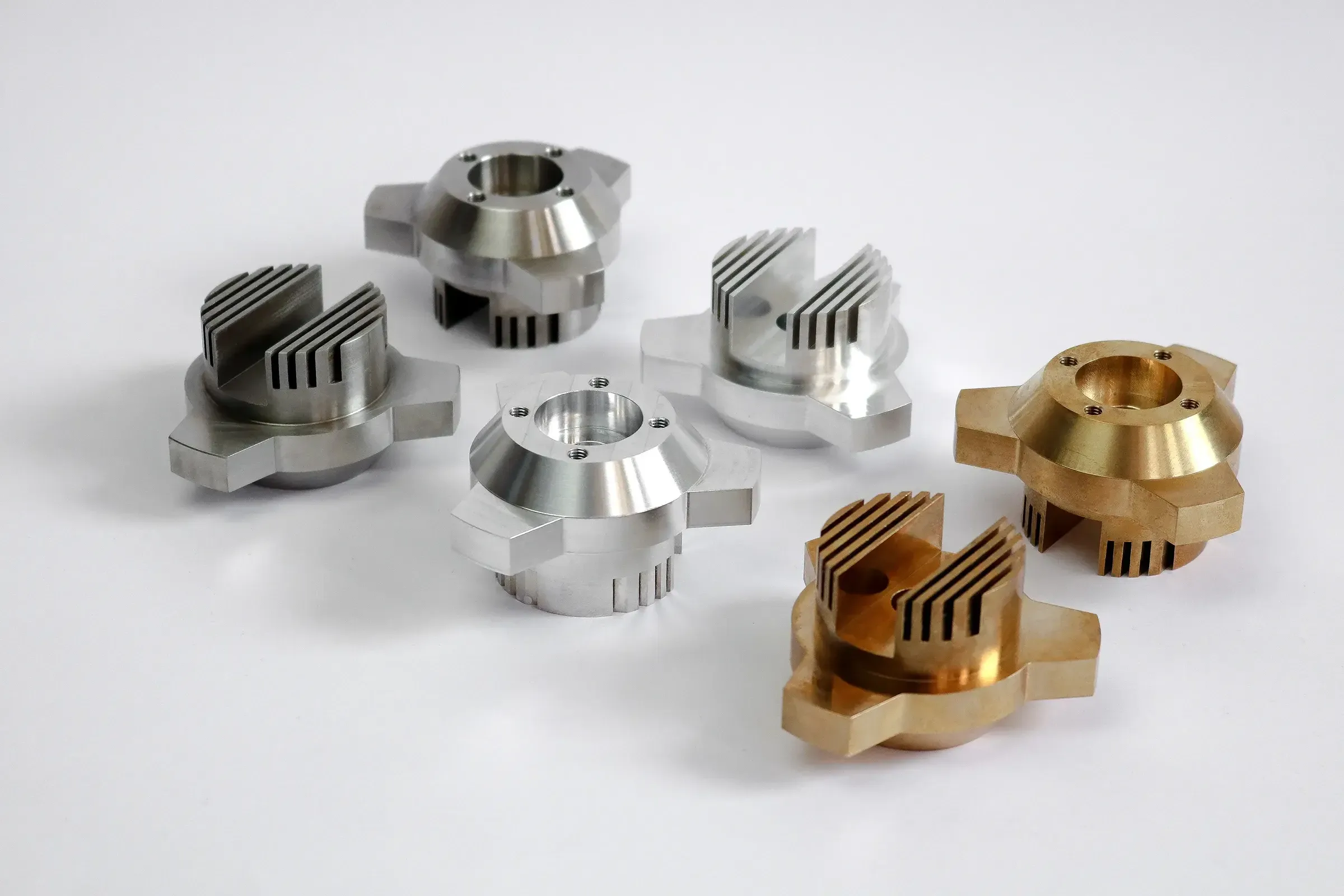

PLN cnc machined parts composition
When to use CNC machining for high-volume production
CNC machining is typically used for low- to medium -volume production, as it is more costly and has longer lead times compared to injection molding and die casting. That said, you may want to consider using CNC machining for high-volume production in the following cases.
  • High precision and tight tolerances. If your parts must be extremely prices, or have very tight tolerances, you may want to consider CNC machining, as it is capable of degrees of accuracy that even injection molding can’t achieve.
  • Material variety. Whereas die casting and injection molding require different molds for different material types, CNC machines can handle a wide variety of materials, including metals and plastics. If your parts need to be made of different materials (for instance, a part which is half made of steel and half of nylon), CNC machining can offer the versatility you need.
  • Customized or changing parts. Similarly to above, in cases where your parts require frequent modification or customization, CNC machining is more adaptable. Unlike injection molding or die casting, where altering the design requires expensive and time-consuming modifications to molds or dies, CNC machining can accommodate changes quickly and cost-effectively.
