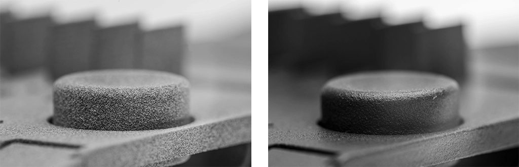

How does chemical vapor smoothing work?
Chemical vapor smoothing enhances part performance and aesthetics. This seals surfaces, making it easier to dye and certify for contact with skin and food while maintaining dimensional accuracy. Chemical vapor smoothing isn’t restricted by line-of-sight only, unlike other post-processing methods. As well, you don’t end up with any fixture marks.
It’s important to note that while chemical vapor smoothing re-distributes surface material to provide a sealed, smoothed surface, it doesn’t create a polished surface. Your part’s surface topology will still be visible, as well as its minimal layer lines.
Pros
Creates a smooth surface finish
Able to smooth out complex geometries, even if not in a direct line of sight
More resistant to dirt
Cons
Softens sharp edges and corners
Not suitable for small features
Not suitable for thin walls
Not suitable for living hinges or lever features
Default MJF finish (left) versus MJF part after chemical vapor smoothing (right)

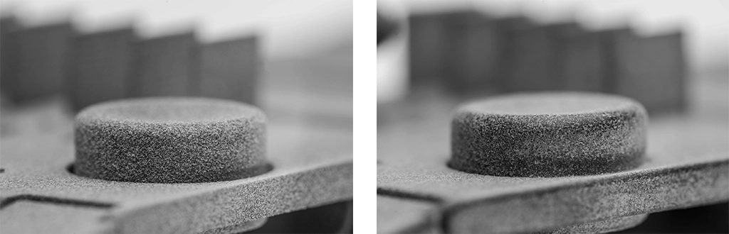

How does media/bead blasting work for SLS and MJF?
Bead blasting uses rounded spherical media that impact the surface of the part, leaving a more uniform finish caused by the sphere “dimpling” the surface. This process is most often used when manufacturers require a smooth, uniform finish or a dull “satin” finish.
Bead blasting involves using a spray gun to shoot fine media in a bead or sphere to smoothen 3D printed objects.
Pros
Strong aesthetic appearance
Cons
Blasting media can get stuck in crevices and gaps in the part
Default MJF (left) versus MJF part after bead blasting
