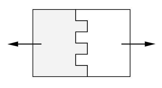

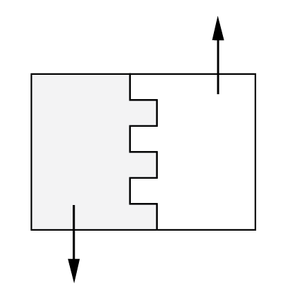

There are 3 forces to consider when designing interlocking joints:
Friction - the critical force that holds the joint together. The tighter the joint is, the higher the friction and the more difficult it will be to pull apart
Tension - the force that acts to pull the joint apart
Shear - the force perpendicular to tension that pulls the joint sideways (a tearing force)
