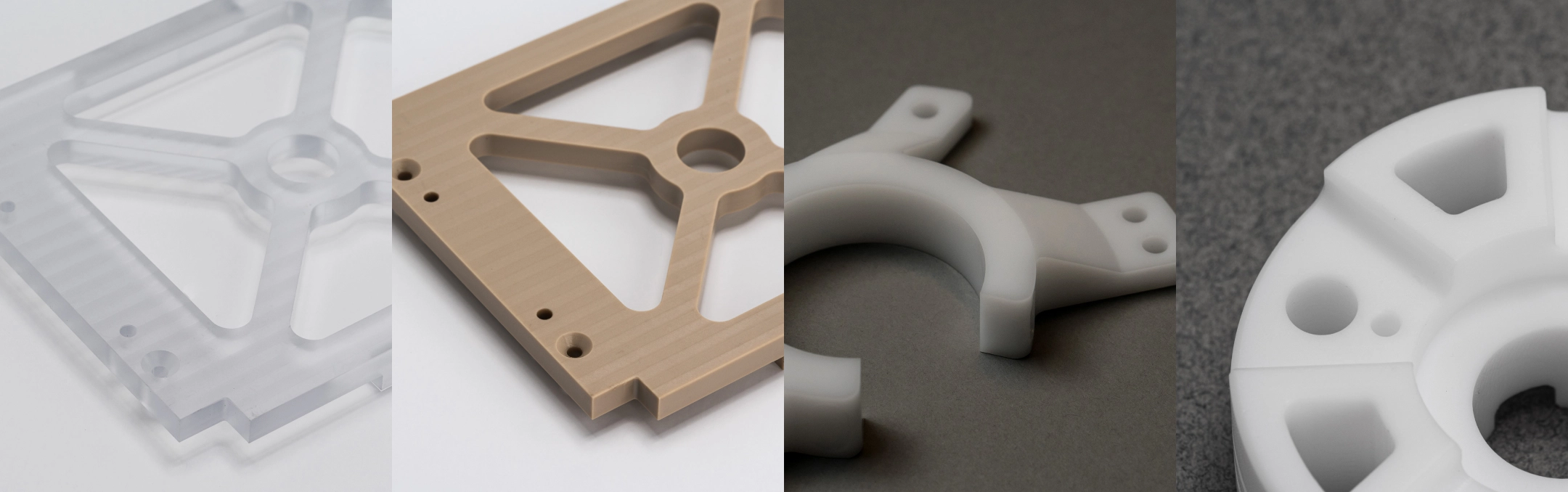

What materials are used to create medical tech with CNC machining?
 The following materials are commonly used to create medical tech with CNC machining.
  • Stainless steel. High-strength material with excellent corrosion resistance for surgical instruments and implantable devices.
  • Titanium. Lightweight and biocompatible material for orthopedic implants and dental prosthetics.
  • PEEK (Polyether Ether Ketone). Biocompatible polymer with high chemical resistance for spinal implants and dental components.
  • Aluminum. Lightweight and corrosion-resistant material for medical equipment housings and structural components.
  • ABS (Acrylonitrile Butadiene Styrene). Durable and impact-resistant polymer for medical device prototypes and casings.
