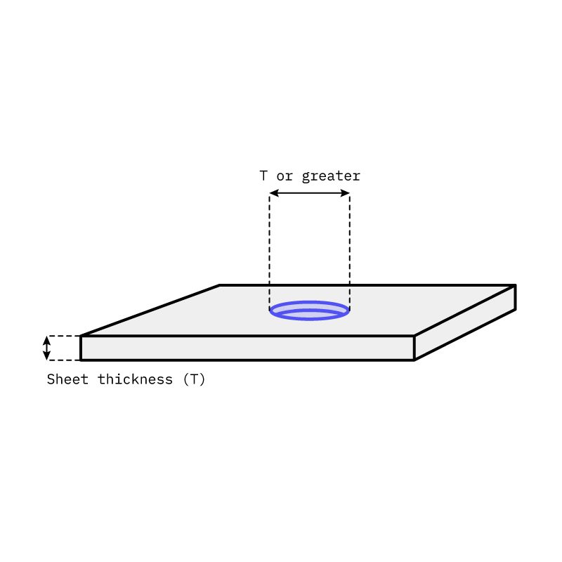

Specify hole diameters larger than the sheet thickness
Holes with a diameter less than the thickness can lead to deformation or may be inaccurate due to the kerf or distortion caused by the laser beam. It is possible to laser cut holes with a diameter smaller than the material thickness, but if you want to stay on the safe side stick to a diameter the same size or greater that the sheet thickness.

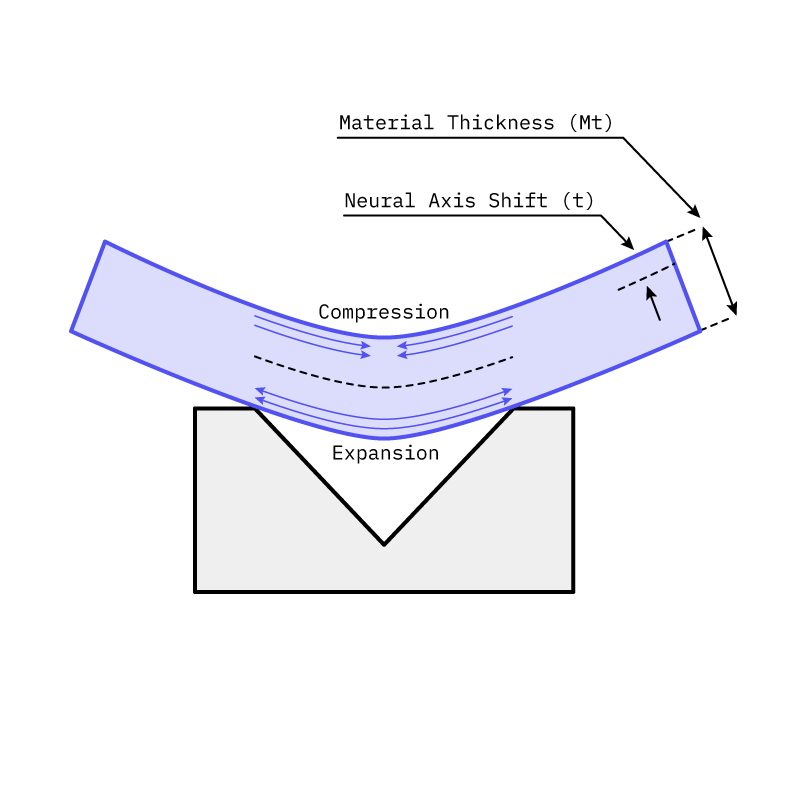

Consider K-factor to avoid deformation and tearing
When bending metal, the material stretches, which consequently shifts the neutral axis away from the center. In order to design a flat pattern correctly and find the right bend allowance, you can find the neutral axis along the bend by calculating the K-factor.
K-factor is a constant that shows the ratio of the neutral axis to the material thickness:
K-factor = t/Mt
K-factor changes based on material, thickness, bend radius, bending method (i.e. air bending vs bottom bending vs coining). Because of all these specific variables it’s hard to calculate K-factor completely accurately, but it should range between 0.3-0.5 mm and the average is 0.4468 mm which is used for most bending applications.
As a guideline, you can use the values in the chart below:
Generic K-factors Soft materials
(e.g. aluminum)
Medium materials
(e.g. steel)
Hard materials
(e.g. stainless steel)
Air bending
0 - Mt. 0.33 0.38 0.40
Mt. - 3x Mt. 0.40 0.43 0.45
> 3x Mt. 0.50 0.50 0.50
Bottoming
0 - Mt. 0.42 0.44 0.46
Mt. - 3x Mt. 0.46 0.47 0.48
Coining
0 - Mt. 0.38 0.41 0.44
Mt. - 3x Mt. 0.44 0.46 0.47
If you want to use a more exact K-factor, rather than use this chart, you’ll need around 3-5 test pieces to gather some information, including bend allowance (BA), bend radius (Ir) and material thickness (Mt). More detailed information on calculating the K-factor can be found in this article.
