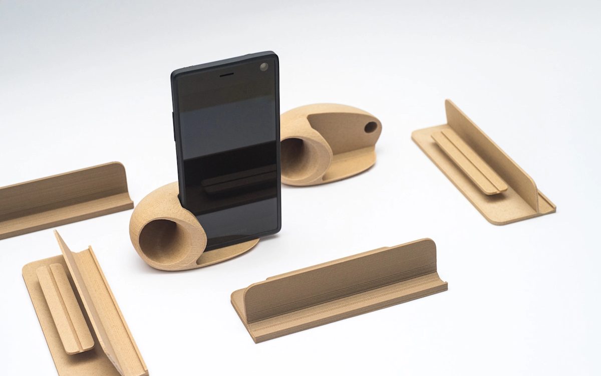

Fairphone 3D printed accessories that are made on demand from recycled wood fiber material
