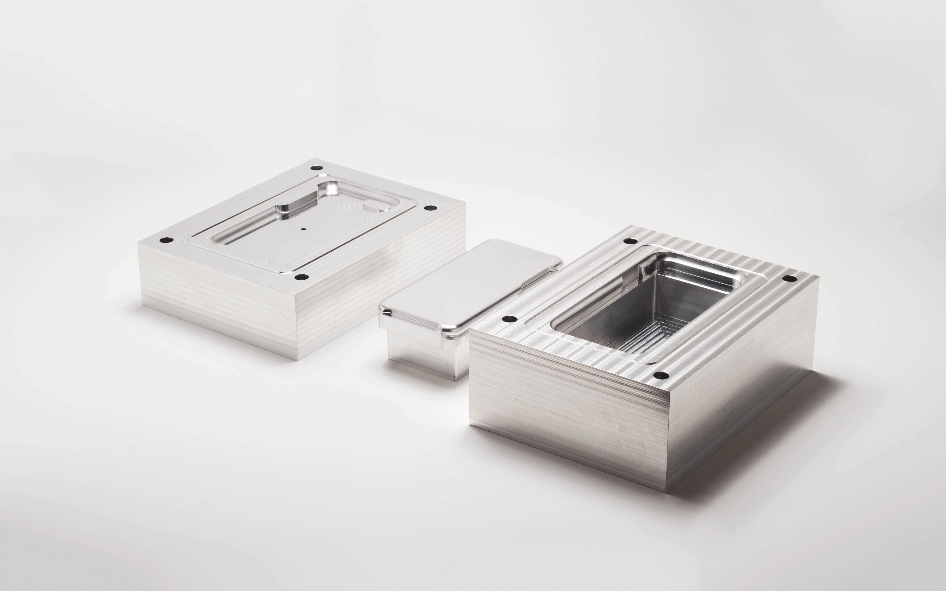

To create the mold for the case, the team used CNC machining through Protolabs Network, to source affordable parts. It was important for this particular project to make the components accessible to those not owning CNC machining capabilities, so it served as a valuable test case as well.

Jerry De Vos was the designer of the iPhone mold. He used a standard CAD file of an iPhone online and basing the design of the mold around it. Jerry knew that the parts he created for the mold could be easily machined due to their simple geometries. The reason CNC machining was used as the manufacturing method was a combination of the high dimensional accuracy (±.125mm) and the materials available (Aluminum 6061 used) that can withstand the heat/pressure of 100's of shots.
DSC02684-Edit-1
DSC02744Top: Back of the mold. Bottom: A close up of the as machined finish of the part
An alternative approach could have been to use 3D printing with laser sintering (SLS) , but the price would have been a lot higher than the €450 they paid for the mold. Finally, using metal 3D printing (SLM) to print the molds directly was not a real good option as the designs were easily machinable and the added benefit of 3D printing was thus low. CNC machining also had the added benefits of being far more accessible not only in price but in regional availability.
After the team received the mold they finished it off by adding threads, screws and some final touches before it was then attached to their home built injection molder. With one big push of the handle, the plastic pellets are pushed through the nozzle at the base forming into the shape of anything your mold is cut to, in this case, an iPhone mold.
