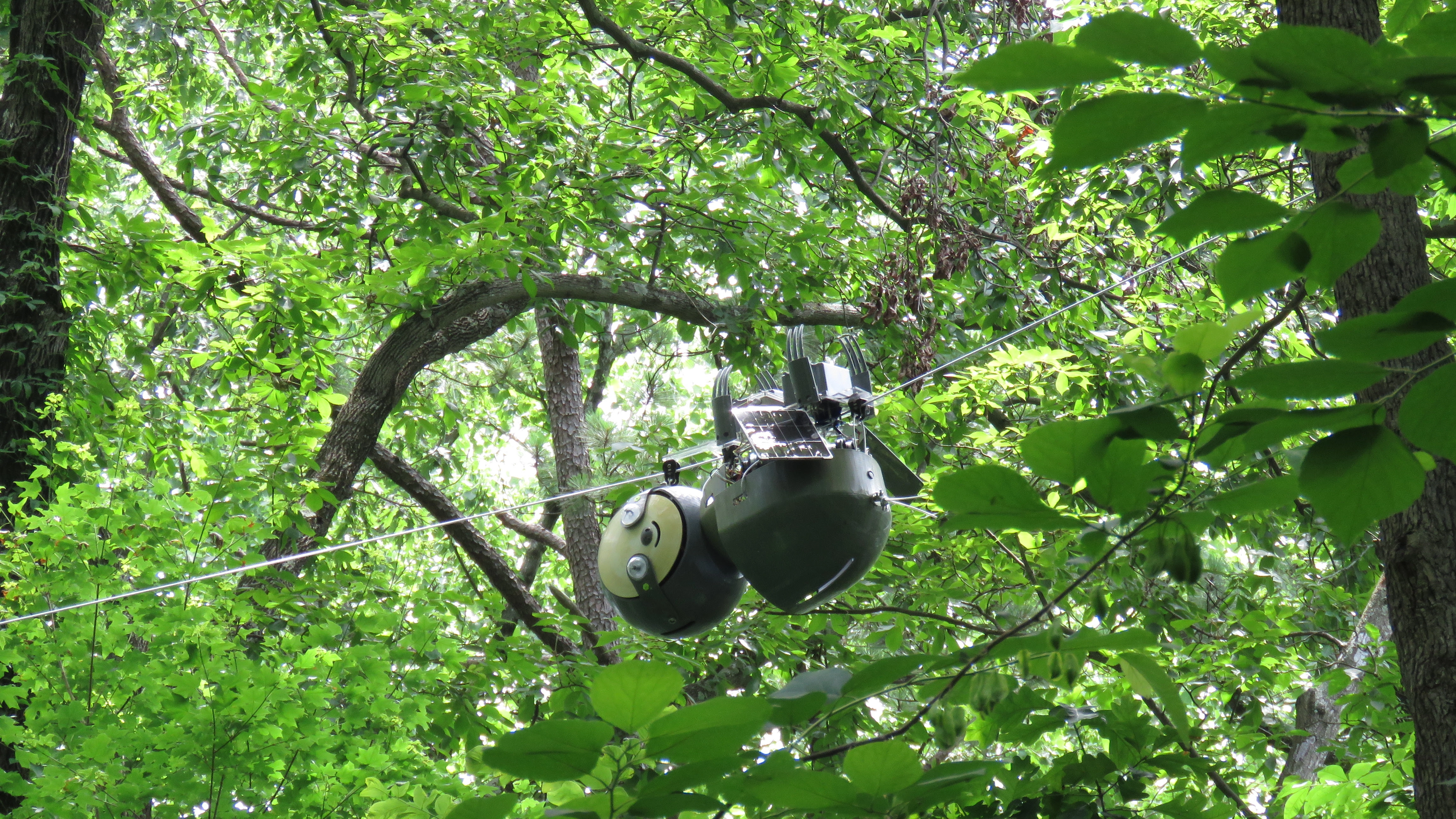

Currently deployed in the Atlanta Botanical Garden, the SlothBot can run (or climb) forever without ever needing to be charged through a power outlet. An extremely energy efficient robot, the SlothBot monitors environmental factors like temperature, weather and carbon dioxide levels.
How does the SlothBot have such a long battery life? Number one: it hangs on a cable and switches off all motors while stationary, which would be impossible for a drone. Secondly it traverses at a slow, slothlike speed.
Programmed with control algorithms to only move when necessary, if the SlothBot is low on charge, it will automatically move until its light intensity and current sensors communicate that enough power is flowing into the battery via its solar panels.
The resulting behavior is very similar to a sloth, moving very slowly and only when absolutely necessary. “That was the reason we shaped the robot like a sloth: because we wanted to convey the message of slowness by design and energy efficiency,” explains Gennaro Notomista, PhD student at Georgia Tech. Energy efficiency is essential in the environmental monitoring world where processes take place over very long periods of time.
