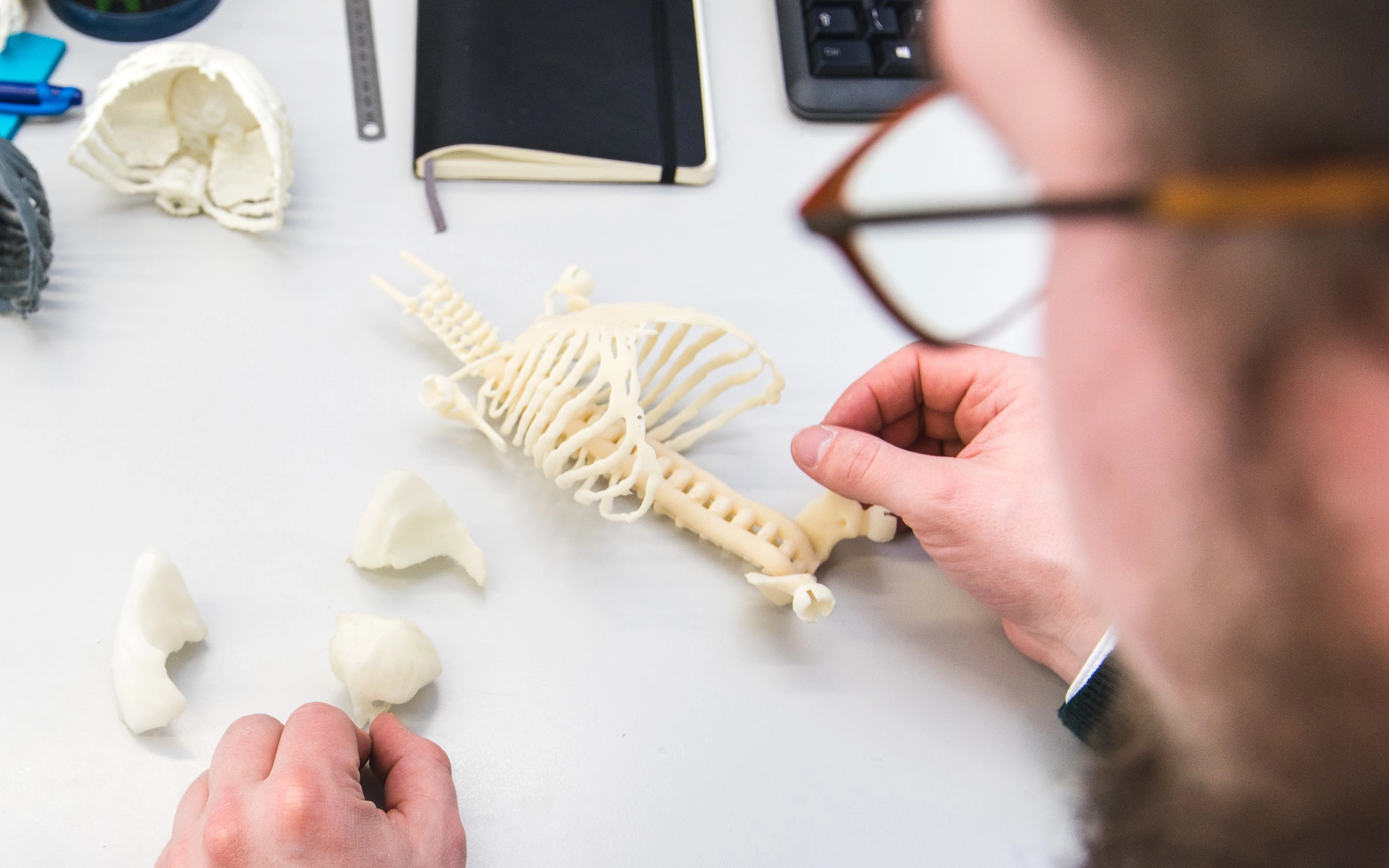

In Mark’s quest to find the material that acts most like a newborn’s internal structures, he’s gone through over 15 different materials, testing them to find out their properties under stress. Mark has used an array of 3D printing technologies, including Fused Deposition Modelling (FDM), Laser Sintering (SLS) and Multi-Material Jetting (MJ). There are two key components to the mannequin: the ribcage, which acts as the housing for the second component, the internal organs, which provide information.

DSC02690--1-
Mark checking the 3D prints in line with the MRI scan
