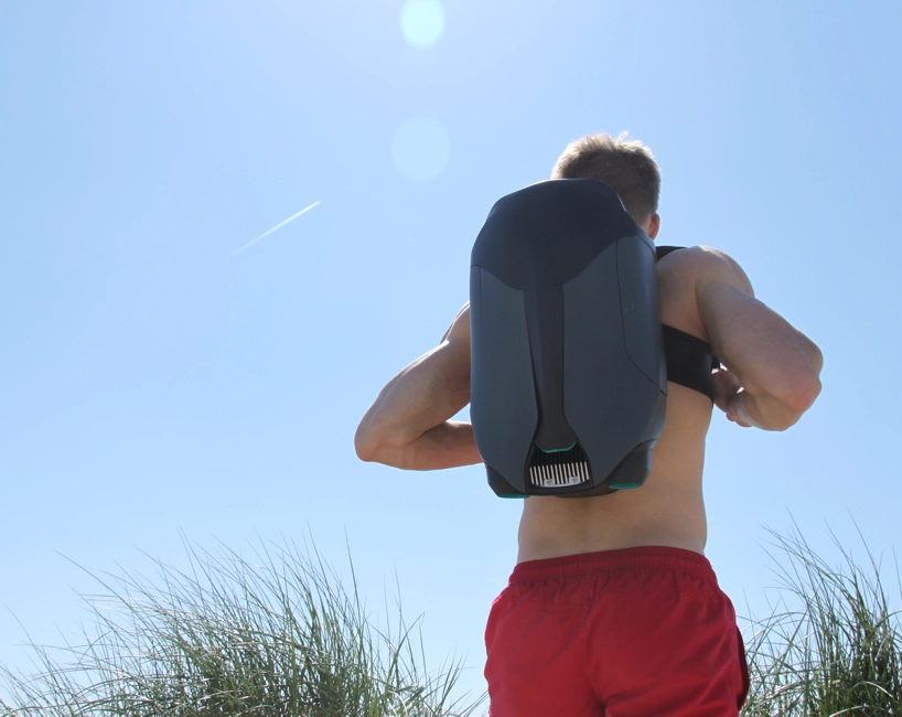

When Archie O’Brien first saw the Seabob promotional videos he was sold, it was only when he saw the price of around $17,000 that he realized how inaccessible the technology truly was. Using 3D printing and working with Protolabs Network Archie designed and built an affordable alternative instead called the CUDA. A jetpack that the user wears like a backpack which gives you a hands-free experience as you glide through the water. What first started out as a student project only a year ago now has potential future applications for water rescue and goes into production next year.

As soon as the designs were finished the first prototype was built. The manufacturing of the first working version used a blend of manufacturing technologies including CNC machining, turning and 3D printing. The predominant technology used was 3D printing, apart from the drive shaft which was turned and the heatsink which was milled. The impressive part of the project is that most of the components used FDM technology and PLA. Both FDM and PLA are the most commonly and easily accessible materials and technologies respectively due to their low cost.
Through Protolabs Network, SLS was used to create the impeller which ordinarily would have been machined but Archie used carbon fiber infused powder which gave extreme stiffness needed for such parts. In short 3D printing allowed Archie to create a functional and robust prototype that previously wouldn’t have been possible with other manufacturing technologies for the same price or turnaround time.
baseengineimpeller
Using 3D printing comes with its challenges when being used in water. Archie uses a few extra materials to keep the CUDA running when submerged. Firstly all the 3D printed parts are coated with a thin layer of epoxy resin which is then slow-dried. Finally, the doors for easy access to the batteries and electronics have silicone seals to keep the water out.
So far the CUDA has been tested in swimming pools and open water. The 3D printed parts have not yet had any issues with leakage or deterioration. This included leaving parts in water for months and in close to freezing conditions. Of course, this isn't a scientific test but shows the sturdiness of this early functional product.
