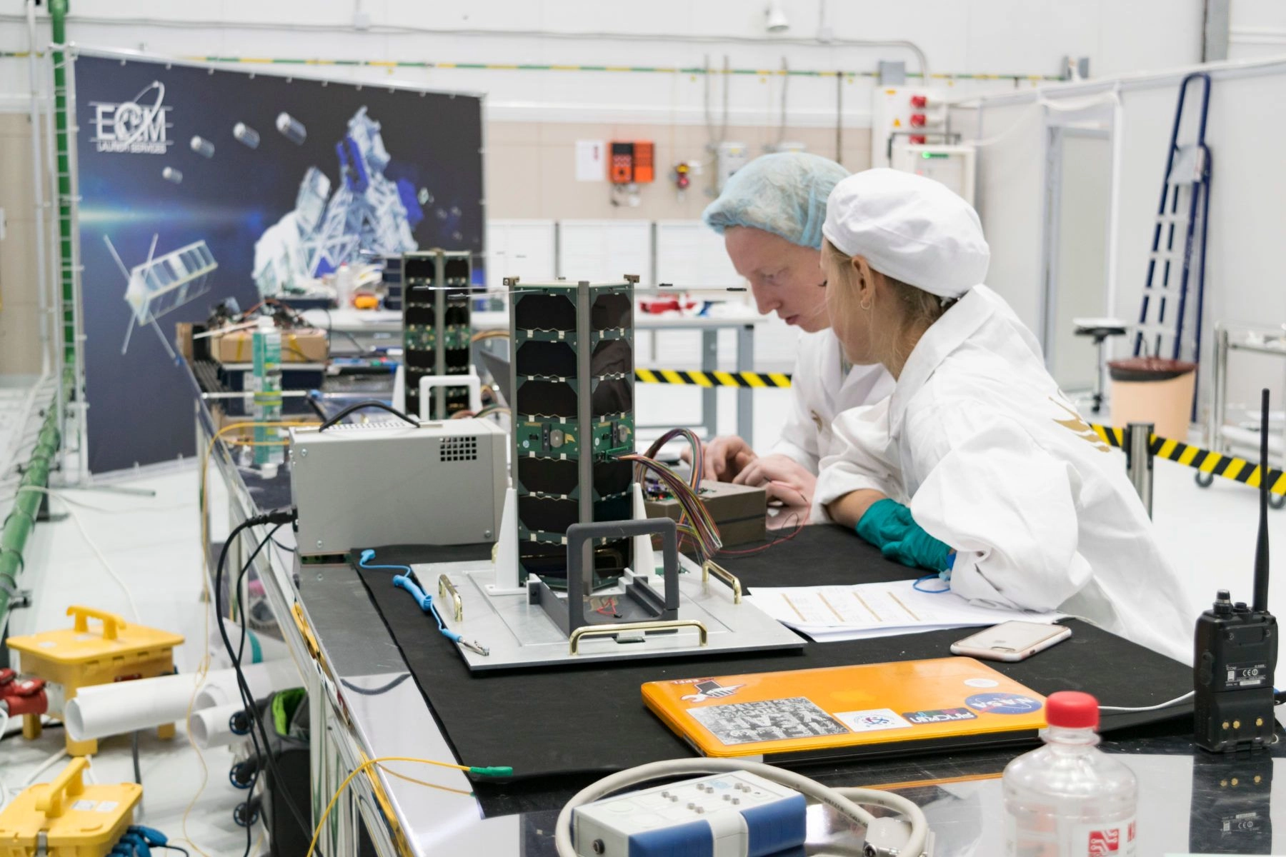

To ensure perfect products, German Orbital Systems (GOS) uses a variety of tools to design CubeSats, microsatellites and custom projects. All CAD work is completed with SolidWorks, and circuit boards are outlined with Altium.
To further verify the designs, engineers use Matlab and SolidWorks Simulation to test for warping, buckling, thermal analysis and communication capabilities. These digital tools let engineers easily run multiple scenarios in a virtual environment, improving design time.
On the hardware side, engineers prototype pretty consistently with an in-office Ultimaker. “We’ll use [the 3D printer] all the time for new mechanisms, structures -- we’ll print everything out to make sure everything fits and for manufacturability,” Jonas explains. Beyond new mechanisms, the company does a fair amount of circuit board assembly in house.
For CubeSats, the general design is fairly standardized and has defined form factors. This is good but can be limiting when customers want to do more with a design or a specific application requires more space than the form factor gives. For this reason, GOS offers microsatellite manufacturing services as well as CubeSats.
Working with the CubeSats speeds up the design process since engineers can rely on standardized structures and components, and can follow similar MIAT procedures for all our CubeSat orders.
On the other hand, microsatellites allow for more creativity, and are a more suitable choice for larger payloads and involved sensing applications. It’s also ideal for GOS clients that want to have more product customization.
According to Jonas, microsatellites often bring engineers more interesting applications but do require longer timelines to ensure all of the components work and properly fit. Though depending on the application, engineers can tweak the Attitude Orbit and Control System (AOCS) and Electric Power Supply (EPS).

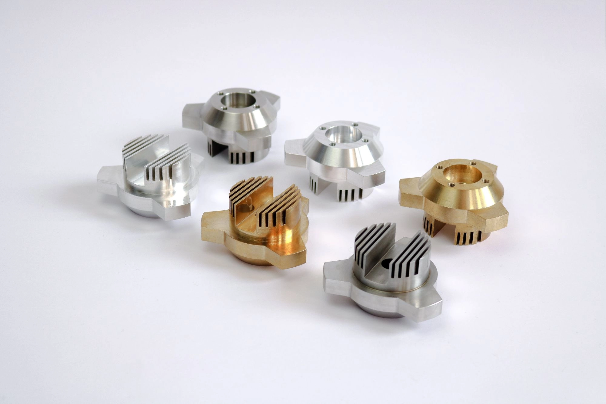

Because GOS uses a small number of materials, this limits potential manufacturing methods. The organization uses CNC milling for satellite structures because they are cut from solid aluminum blocks. This technique provides repeatability, easier management through software-based workflows and reliable round-the-clock production.

For both CubeSats and microsatellites, engineers want consistent material properties, minimal weight, and predictable costs. For the majority of designs, engineers rely on aerospace grade Aluminum 6061.
“Aluminum 6061 is chosen for its strength, its cost and its lightness. It also has low corrosion properties, which makes it common for aerospace applications,” says Jonas. Because of these factors, GOS uses aluminum alloys for the frames.
