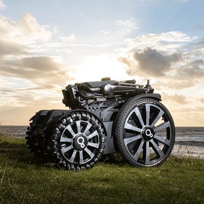

In 2015, Eaglesham founded Conquering Horizons in response to frustration with existing wheelchair products. He introduced the market to one of the most innovative recent breakthroughs in disabled mobility, an overhauled wheelchair dubbed Victor.
The wheelchair was designed in collaboration with the University of Sheffield Advanced Manufacturing Research Center (AMRC) and SC Innovation, a division of the SC Group, well known for its Supacat high-mobility military vehicles. At the Institution of Engineering Designers Awards in 2018, Eaglesham’s prototype was awarded the Alex Moulton Award for product innovation.
Victor is an impressive leap forward for wheelchair design in many ways. It sports multi-directional, all-terrain wheels that can mount curbs, can travel 20 miles on a single charge and is compact and foldable for travel purposes. As well, the wheelchair allows for movement at a “social height,” so, as Eaglesham states, “disabled people don’t feel like second-class citizens.”
