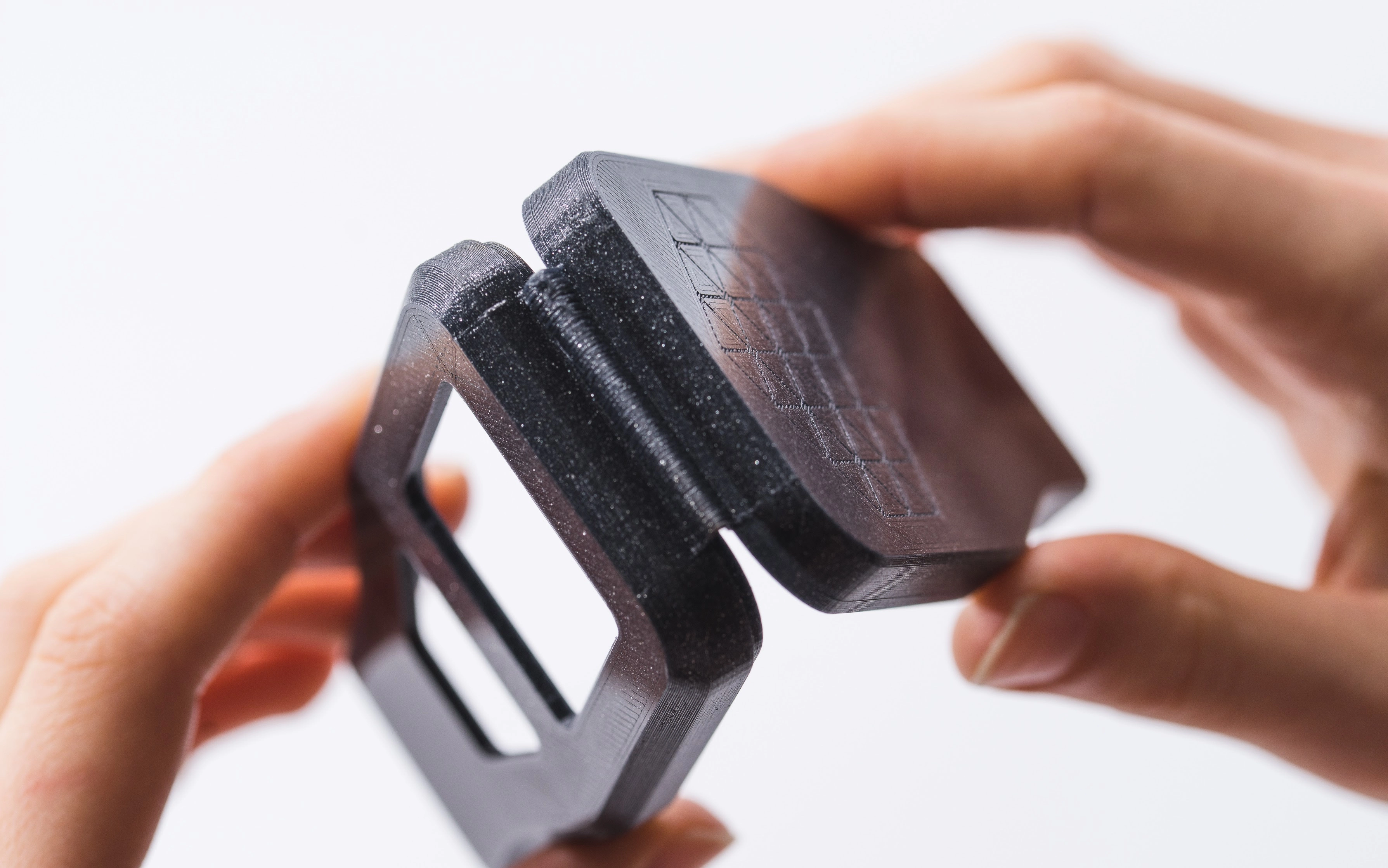

This guide demonstrates 3D modeling techniques for creating functional living hinges. Fusion 360 has been used to model these parts but most CAD packages are very similar in operation. If you don’t currently have Fusion you can download a free copy for hobbyist use here.
Enclosure with completed living hinge.
Close-up view of completed living hinge.

The sketch can now be created on this plane, referencing the edges of the case parts using a coincident constraint. This will ensure the sketch is automatically updated if either of the case parts are moved. After testing a few different variations on geometry and dimensions of the living hinge the most effective was found to be a 1mm section, tapering down to 0.6mm for the main hinge.
This gives good strength at the sides and controls where the hinge will bend. As a hinge is closed the outer surface is placed under tension while the inner surface is compressed. This stretches the outer surface of the hinge. To account for this, a good living hinge design has a long curve length on the outer surface and a short inner surface.

The living hinge feature is now complete, for more information on living hinge design you can refer to this article.
Completed living hinge part.
