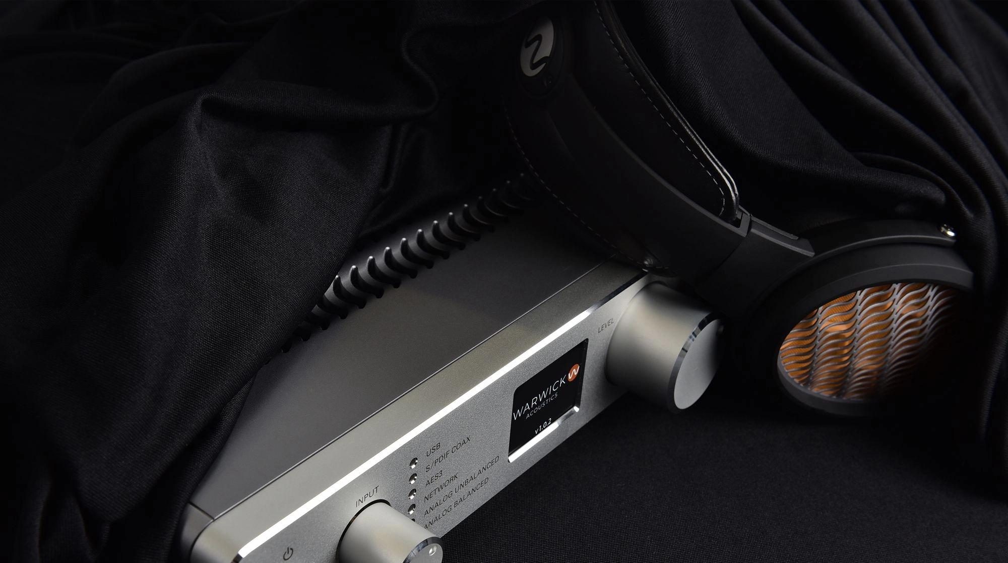

Warwick Acoustics’ headphones are above and beyond today’s standard, turning the traditional speaker design on its head. Rather than taking the traditional approach of using a heavy magnet and a coil that alternately attract and repel, and making a cone vibrate in order to create sound, Warwick Acoustics has opted to build an electrostatic speaker.
It’s a system others have attempted, but in the past has resulted in large, heavy speakers with little control over low frequencies that deteriorate over time. Warwick Acoustics overcomes these issues by creating a patented cellular structure that produces sound reliably.
Next generation headphones
In the place of the magnet that moves backward and forward, Warwick Acoustics uses a very, very thin diaphragm film - thinner than a human hair.
Warwick Acoustics’ Composite multilayer film diaphragm
The light weight of this film means the speakers are more true to the sound. In a traditional speaker, the heavy magnet results in a slight delay, often blurring and smudging the sound. Because of the light membrane, Warwick Acoustics’ headphones produce a more “transparent”, cleaner sound.
“The example often used to describe this transformation is LEDs versus traditional light bulbs,” explains Ben Lisle, Principal Mechanical Engineer at Warwick Acoustics. “The LED is the next generation. It has all the advantages of a light bulb, but with lower power, brighter light, and no heat emitted. It’s the same with our headphones: they offer everything traditional headphones can but with a cleaner sound, much lower power, and low heat emission.”
Warwick Acoustics’ Balanced-Drive High Precision Electrostatic Laminate (BD-HPEL)
To make the electrostatic speakers reliable, Warwick Acoustics have created their self-coined Balanced-Drive High Precision Electrostatic Laminate (BD-HPEL). The diaphragm is centered between 2 thin, high-precision electrical stators using polymer spacers, laser-cut in house.
Each stator is made from oxygen-free copper (OFHC), which is subsequently gold-plated, materials selected for their high electrical conductivity, resistance to corrosion and premium aesthetics. The entire assembly is built into a high-precision frame, which ensures the assembled transducer is held completely flat and is invulnerable to warpage or bending.
