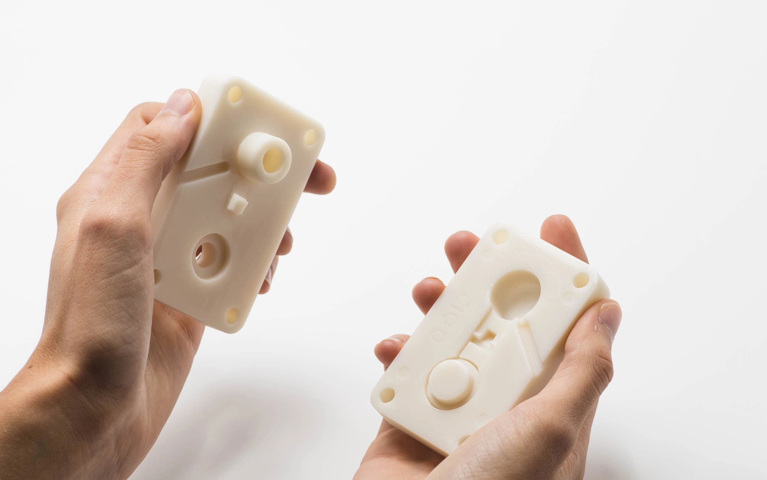

Rapid tooling helps make high-performing prototyping tools a reality. Traditionally 15 days to create a quality tool is acceptable but thanks to 3D printing you can do it in less than a week at the half of the total cost. This is down to the cost of materials, the ability of SLA technology to create complex geometries and the amount of time it take to do so.
MOLD3D printed injection mold alongside an ABS part it created

In general most 3D printed tooling produced parts successfully in two-digit quantities when the molding material was a member of the polyolefin family. However, significant performance differences arose when the molding materials tested were those of the high-engineering grades. In these cases, Somos PerFORM outperformed competitors with inserts successfully providing molded parts in shot quantities exceeding 100. The majority of the competitive additive manufacturing material inserts were breaking before producing even 25 parts. See a more detailed comparison of 3D printed injection molding materials on our Knowledge Base.
A close up of a 3D printed mold with the part still in it.
