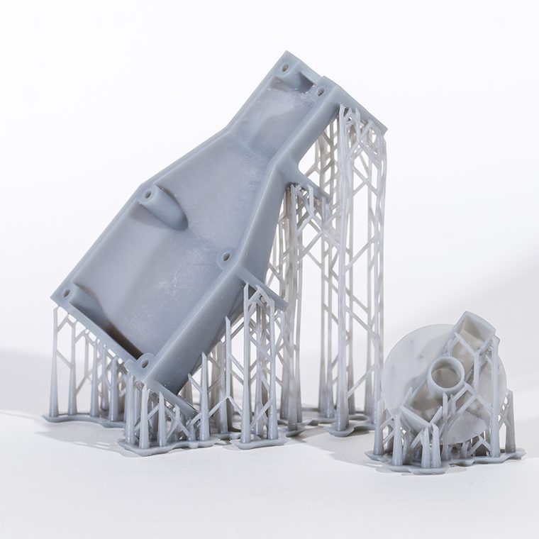

SLA can produce parts with very high dimensional accuracy and intricate details.
SLA parts have a very smooth surface finish, making them ideal for visual prototypes.
Speciality SLA materials are available, such as clear, flexible and castable resins.
• SLA parts are generally brittle and not suitable for functional prototypes, though industrial SLA can produce more functional components for this stage.
• The mechanical properties and visual appearance of SLA parts will degrade over time when the parts are exposed to sunlight.
• Support structures are always required and post-processing is necessary to remove the visual marks left on the SLA part.
